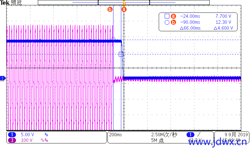

THOLD_UP @ AC100V,100% Load
  THOLD_UP @ AC240V,100% Load

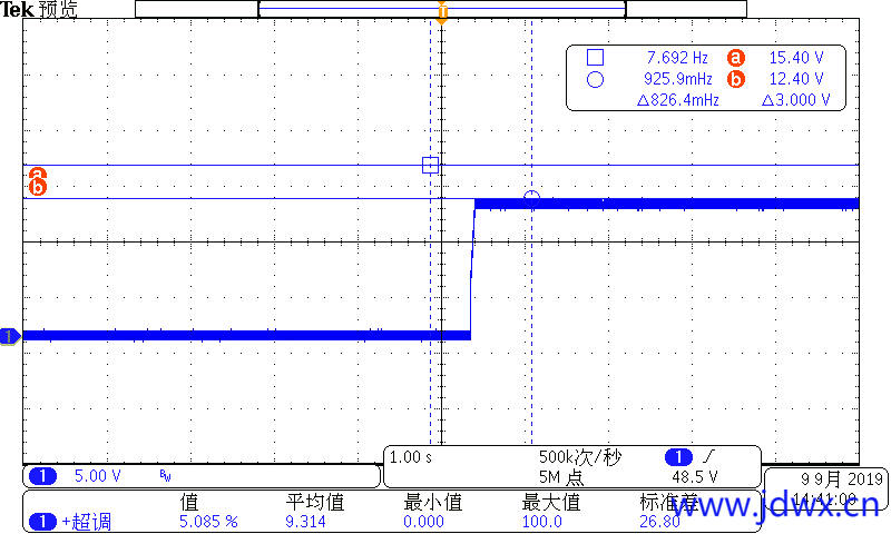

  VOVER_SHORT @ AC100V,100% Load
  VOVER_SHORT @ AC240V,100% Load

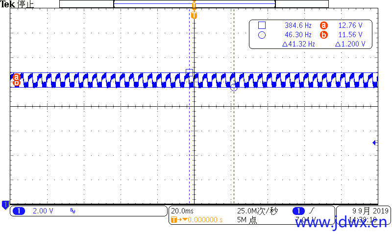

  4.6、动态ce测试:
  注:输出动态负载【电流】设置为1A 持续5/10ms,然后为0A 持续5/10ms并持续循环,上升/下降设置为3A/us。
  AC90V @ 5ms
  AC90V @ 10ms
  AC264V @ 5ms
