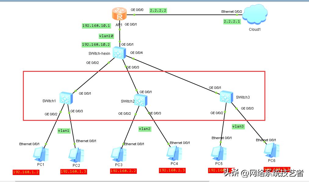

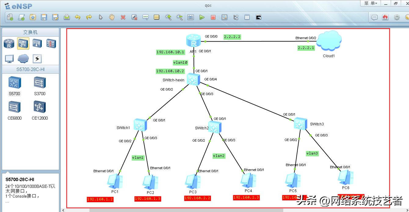

1、不同vlan 下的客户端能够访问外网【2.2.2.1】
2、了解路由器和三层交换机之间的连接及配置
3、了解三层交换机和接入交换机之间的连接及配置实验拓扑图:实验设备及版本:

一、建立物理连接
按照拓扑图进行组网

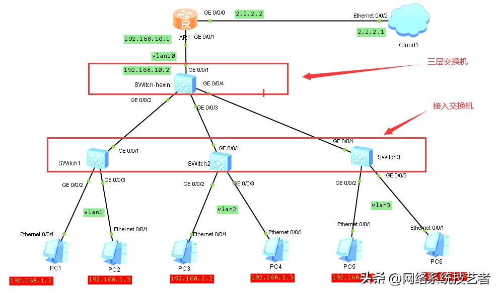

二、接入交换机配置
这里以红框内的第一个交换机为例

三、三层交换机配置
#创建VLAN接口并配置IP地址:sysEnter system view, return user view with Ctrl+Z.[Huawei]undo in[Huawei]undo info-center en[Huawei]undo info-center enableInfo: Information center is disabled.[Huawei][Huawei]interface Vlanif 1[Huawei-Vlanif1]ip address 192.168.1.1 24[Huawei-Vlanif1][Huawei-Vlanif1]q[Huawei]int[Huawei]interface vlan[Huawei]interface Vlanif 2Error: The VLAN does not exist.[Huawei]vlan batch 2 to 3Info: This operation may take a few seconds. Please wait for a moment...done.[Huawei][Huawei]interface Vlanif 2[Huawei-Vlanif3][Huawei-Vlanif3]ip ad[Huawei-Vlanif3]ip address 192.168.2.1 24[Huawei-Vlanif3][Huawei-Vlanif3]q[Huawei]int[Huawei]interface vla[Huawei]interface Vlanif 3[Huawei-Vlanif3][Huawei-Vlanif3][Huawei-Vlanif3]ip add[Huawei-Vlanif3]ip address 192.168.3.1 24[Huawei-Vlanif3][Huawei-Vlanif3][Huawei-Vlanif3]q[Huawei][Huawei][Huawei]sysna[Huawei]sysname Switch-Hexin[Switch-Hexin][Switch-Hexin]#配置三层交换机上连接到接入交换机的接口为Trunk模式,并允许相应VLAN通过:[Switch-Hexin]interface GigabitEthernet 0/0/2[Switch-Hexin-GigabitEthernet0/0/2]port link-type trunk[Switch-Hexin-GigabitEthernet0/0/2]port trunk allow-pass vlan 1 to 3[Switch-Hexin-GigabitEthernet0/0/2]q# 配置与路由器相连的接口[Switch-Hexin][Switch-Hexin]vlan batch 10Info: This operation may take a few seconds. Please wait for a moment...done.[Switch-Hexin][Switch-Hexin]interface GigabitEthernet 0/0/1[Switch-Hexin-GigabitEthernet0/0/1][Switch-Hexin-GigabitEthernet0/0/1]port link-type access[Switch-Hexin-GigabitEthernet0/0/1]port default vlan 10[Switch-Hexin-GigabitEthernet0/0/1]q[Switch-Hexin]interface Vlanif 10[Switch-Hexin-Vlanif10]ip address 192.168.10.2 24[Switch-Hexin-Vlanif10][Switch-Hexin-Vlanif10]q[Switch-Hexin]#配置静态路由[Switch-Hexin][Switch-Hexin]ip route-static 0.0.0.0 0.0.0.0 192.168.10.1[Switch-Hexin]

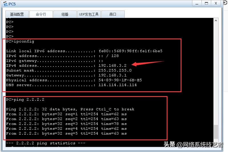

五、测试:写在最后:
