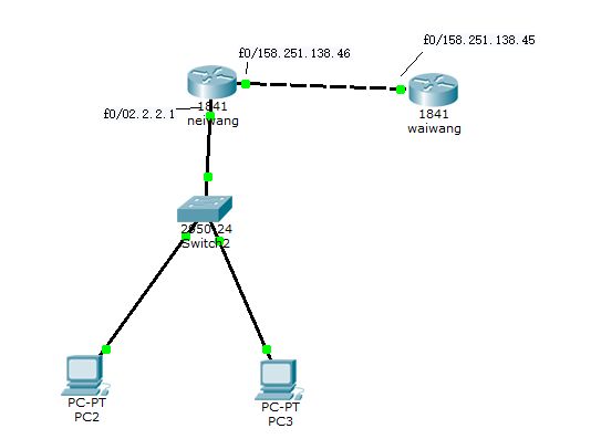

三、思科路由器连接交换机的配置
如上图:
ip地址设置如图再次不再写命令
waiwang路由器设置如下:
Router#sh run
Building configuration...
Current configuration : 550 bytes
version 12.4
no service timestamps log datetime msec
no service timestamps debug datetime msec
no service password-encryption
hostname Router
spanning-tree mode pvst
interface FastEthernet0/0
no ip address
duplex auto
speed auto
shutdown
interface FastEthernet0/1
ip address 58.251.138.45 255.255.255.0
duplex auto
speed auto
interface Vlan1
no ip address
shutdown
ip classless
ip route 2.2.2.0 255.255.255.0 58.251.138.46
neiwang路由设置
Current configuration : 656 bytes
version 12.4
hostname Router
ip dhcp pool 123
network 2.2.2.0 255.255.255.0
default-router 2.2.2.1
dns-server 2.2.2.1
ip address 2.2.2.1 255.255.255.0
duplex auto
speed auto
ip address 58.251.138.46 255.255.255.0
duplex auto
speed auto
interface Vlan1
no ip address
shutdown
ip classless
ip route 58.251.138.0 255.255.255.0 58.251.138.45

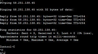

测试结果
