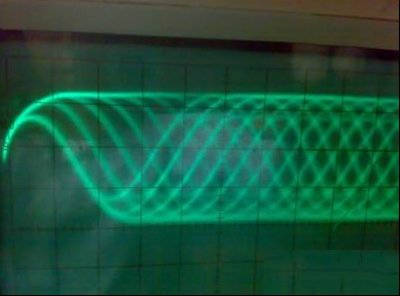

发表于 2024-5-7 10:21:50 | 显示全部楼层
RF图怎样才算好?
GMT+8, 2025-12-22 23:33 , Processed in 0.244284 second(s), 24 queries .
