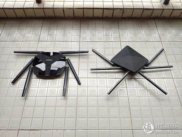

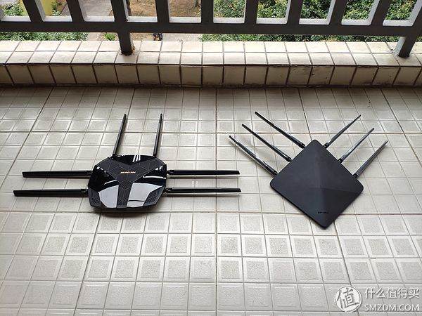

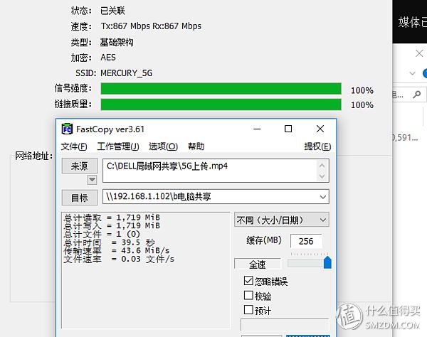

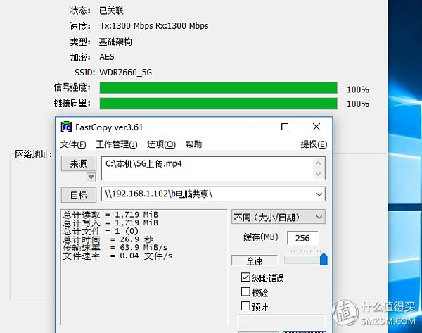

2、fastcopy(5G WiFi上行)
TPLINK WDR7660
