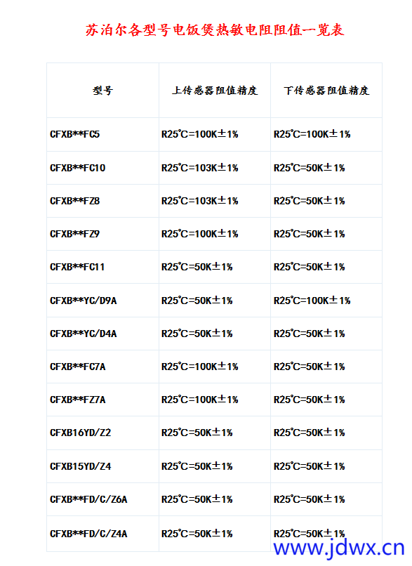

苏泊尔各型号电饭煲热敏电阻阻值览表
型号
上传感器阻值精度
下传感器阻值精度
CFXB**FC5
R25℃=100K±1%
R25℃=100K±1%
CFXB**FC10
R25℃=103K±1%
R25℃=50K±1%
CFXB**FZ8
R25℃=103K±1%
R25℃=50K±1%
CFXB**FZ9
R25℃=100K±1%
R25℃=50K±1%
CFXB**FC11
R25℃=50K±1%
R25℃=50K±1%
CFXB**YC/D9A
R25℃=50K±1%
R25℃=100K±1%
CFXB**YC/D4A
R25℃=50K±1%
R25℃=50K±1%
CFXB**FC7A
R25℃=100K±1%
R25℃=50K±1%
CFXB**FZ7A
R25℃=100K±1%
R25℃=50K±1%
CFXB16YD/Z2
R25℃=50K±1%
R25℃=50K±1%
CFXB15YD/Z4
R25℃=50K±1%
R25℃=50K±1%
CFXB**FD/C/Z6A
R25℃=50K±1%
R25℃=50K±1%
CFXB**FD/C/Z4A
R25℃=50K±1%
R25℃=50K±1%
