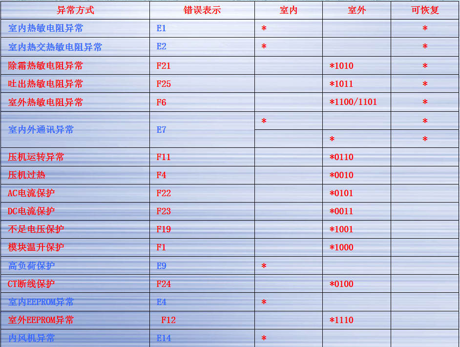

KFR-28(32)GW/HA(DBPF)或KFR-28(32)GW/HC(BPF)故障显示代码
