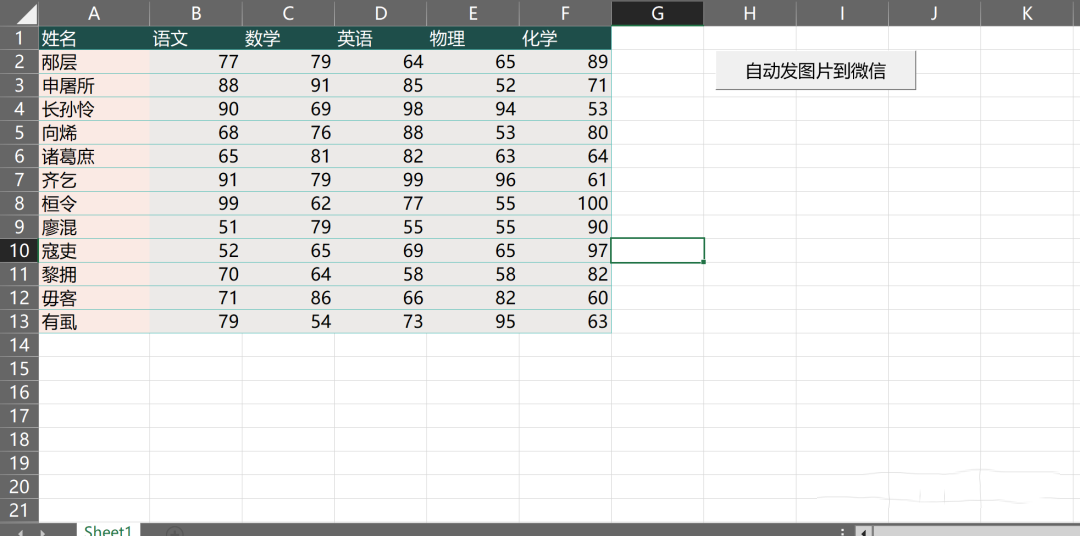

有如图所示成绩表,现在需要将它自动发送到微信

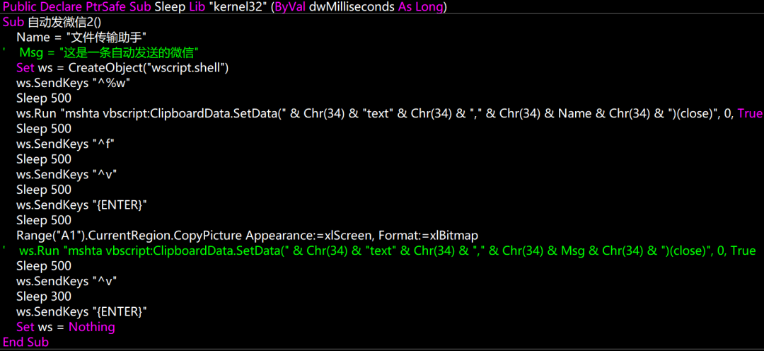

Public Declare PtrSafe Sub Sleep Lib "kernel32" (ByVal dwMilliseconds As Long)Sub 自动发微信2()    Name = "文件传输助手"'    Msg = "这是一条自动发送的微信"    Set ws = CreateObject("wscript.shell")    ws.SendKeys "^%w"    Sleep 500    ws.Run "mshta vbscript:ClipboardData.SetData(" & Chr(34) & "text" & Chr(34) & "," & Chr(34) & Name & Chr(34) & ")(close)", 0, True    Sleep 500    ws.SendKeys "^f"    Sleep 500    ws.SendKeys "^v"    Sleep 500    ws.SendKeys "{ENTER}"    Sleep 500    Range("A1").CurrentRegion.CopyPicture Appearance:=xlScreen, Format:=xlBitmap'    ws.Run "mshta vbscript:ClipboardData.SetData(" & Chr(34) & "text" & Chr(34) & "," & Chr(34) & Msg & Chr(34) & ")(close)", 0, True    Sleep 500    ws.SendKeys "^v"    Sleep 300    ws.SendKeys "{ENTER}"    Set ws = NothingEnd Sub其实对于工作表区域,我们只需要利用单元格对象的CopyPicture就可以将单元格区域复制为图片。所以相对于之前的文本发送到微信,只需更改第16行代码。这里就不多解释代码含义了,不懂的可以参考前两篇
使用VBA自动发微信
VBA自动发微信2
效果如下:

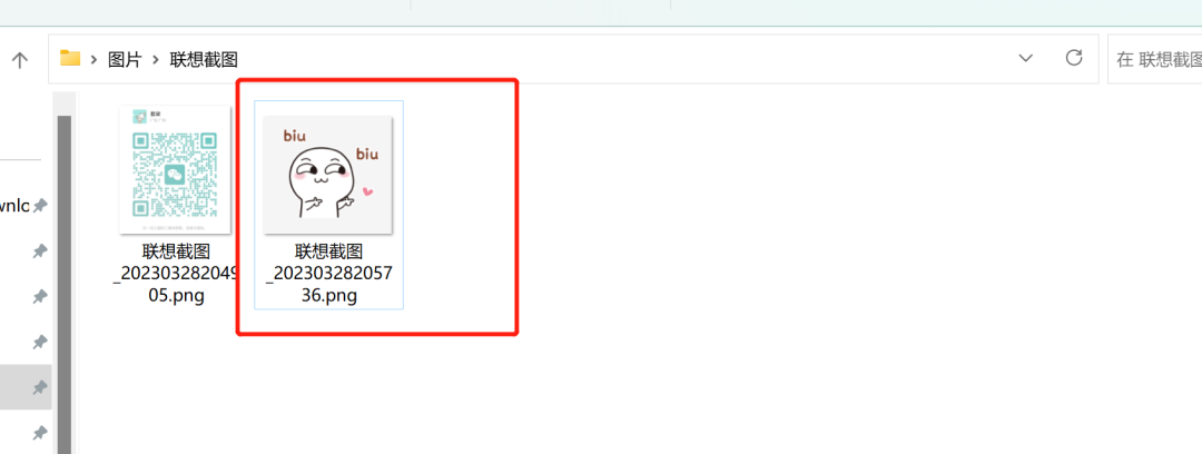

二、将文件夹图片发送到微信‍如下图所示,我要将以下图片发送到微信‍‍

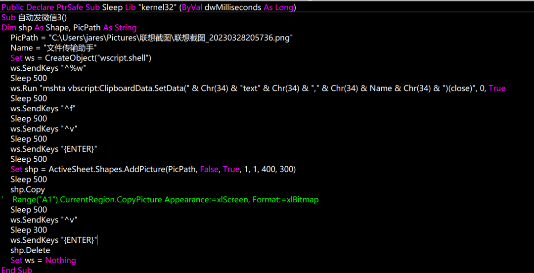

Public Declare PtrSafe Sub Sleep Lib "kernel32" (ByVal dwMilliseconds As Long)Sub 自动发微信3()Dim shp As Shape, PicPath As String    PicPath = "C:\Users\jares\Pictures\联想截图\联想截图_20230328205736.png"    Name = "文件传输助手"    Set ws = CreateObject("wscript.shell")    ws.SendKeys "^%w"    Sleep 500    ws.Run "mshta vbscript:ClipboardData.SetData(" & Chr(34) & "text" & Chr(34) & "," & Chr(34) & Name & Chr(34) & ")(close)", 0, True    Sleep 500    ws.SendKeys "^f"    Sleep 500    ws.SendKeys "^v"    Sleep 500    ws.SendKeys "{ENTER}"    Sleep 500    Set shp = ActiveSheet.Shapes.AddPicture(PicPath, False, True, 1, 1, 400, 300)    Sleep 500    shp.Copy'    Range("A1").CurrentRegion.CopyPicture Appearance:=xlScreen, Format:=xlBitmap    Sleep 500    ws.SendKeys "^v"    Sleep 300    ws.SendKeys "{ENTER}"    shp.Delete    Set ws = NothingEnd Sub第4行:指定图片路径第17行:将图片插入Excel,注意根据图片大小调整Sleep时间,否则可能发不过去第19行:复制图片第25行:将刚插入的图片删除
