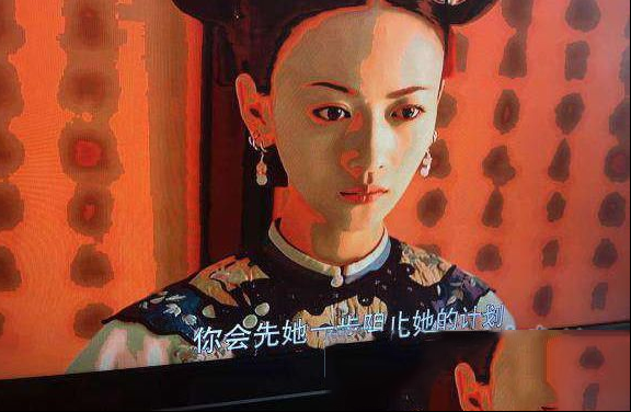

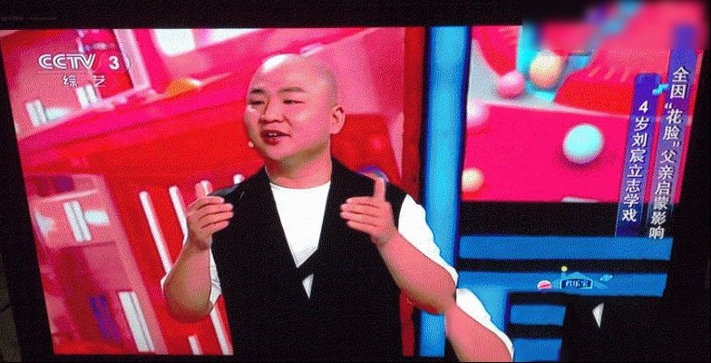

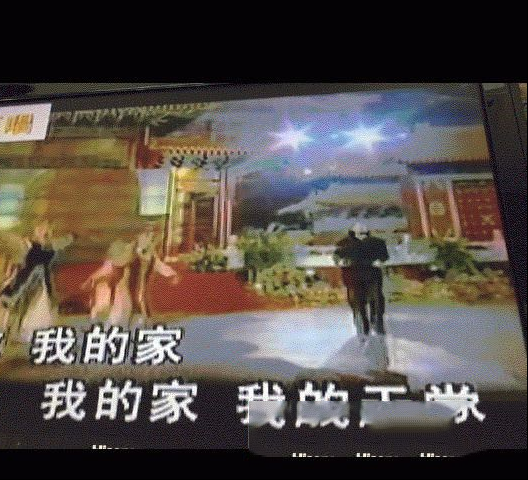

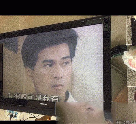

一台海信TLM4236P液晶电视,故障表现是出现图像偏红和人脸有阴影,当采用HDMI信号输入时尤其明显,当用AV输入时稍微好一点,如下图1所示。根据此现象,怀疑是逻辑板导致,最终发现的逻辑板上的伽马电路出现了问题,后来更换逻辑板成功修复,图像、声音等一切正常。现将逻辑板更换前后的伽马电压测量后供大家参考。
                出故障时,我的逻辑板的伽马电压如下:
        GMA1:13.12V   ,GMA2:  11.49V  GMA3:  10.81V  GMA4:  10.11V  GMA5: 9.87V  GMA6:  10.46V  GMA7:  9.07V  GMA8:  8.32V   GMA9:7.93V    ,GMA10: 5.63V   GMA11: 5.20V   GMA12:  4.62V  GMA13: 4.16V  GMA14: 3.87V  GMA15: 3.37V  GMA16:2.51V    GMA17:1.82V
        更换逻辑板后,修理成功以后测得逻辑板的伽马电压如下:
        GMA1:13.18V   ,GMA2:  11.44V  GMA3:  10.77V  GMA4:  9.95V  GMA5: 9.53V  GMA6:  9.20V  GMA7:  8.78V  GMA8:  8.21V   GMA9:7.71V    ,GMA10: 5.58V   GMA11: 5.14V   GMA12:  4.59V  GMA13: 4.15V  GMA14: 3.79V  GMA15: 3.34V  GMA16:2.50v  GMA17:1.81V
