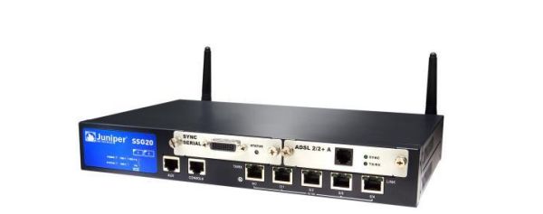

一、juniper路由器怎么开启web登录
juniper路由器开启web登录可以使用如下命令:
set system services web-management management-url admin;
set system services web-management http port 7777;
set system services web-management http interface reth0.X;
set system services web-management https system-generated-certificate;
juniper路由器参数如下:
电源电压:AC 100-240V,47-63Hz
电源功率:DC(满配):576W
AC(满配):800W
产品尺寸:222×445×457mm
产品重量:36kg
其它性能:半双工汇聚吞吐量 16Gbps
每个插槽的全双工吞吐量是4Gbps
每个机箱支持8个PIC
