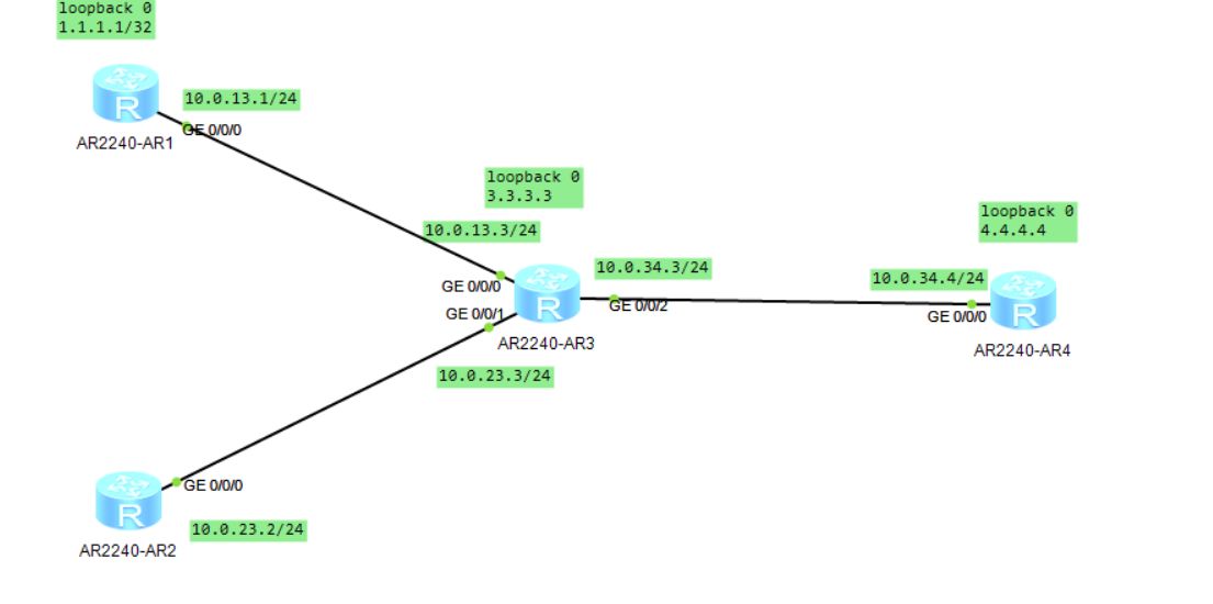

的Rule-ID的顺序,从大到小进行匹配。实验图 224421dqmihygy7mmqih47.png 1.配置接口IP: 224422imlz06353egj6d03.png

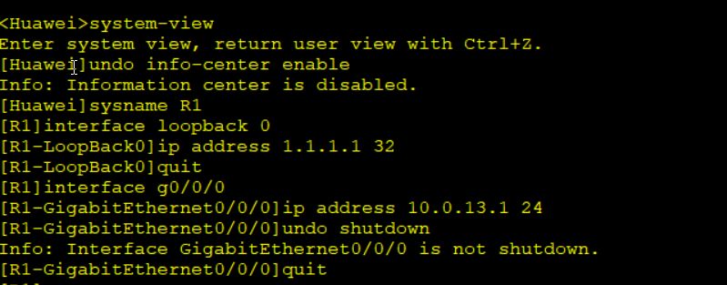

R1配置接口IP
system-view
[Huawei]undo info-center enable
[Huawei]sysname R1
[R1]interface loopback 0
[R1-LoopBack0]ip address 1.1.1.1 32
[R1-LoopBack0]quit
[R1]interface g0/0/0
[R1-GigabitEthernet0/0/0]ip address 10.0.13.1 24
[R1-GigabitEthernet0/0/0]undo shutdown
[R1-GigabitEthernet0/0/0]quit 224422yaz2ivvtsotit2vk.png

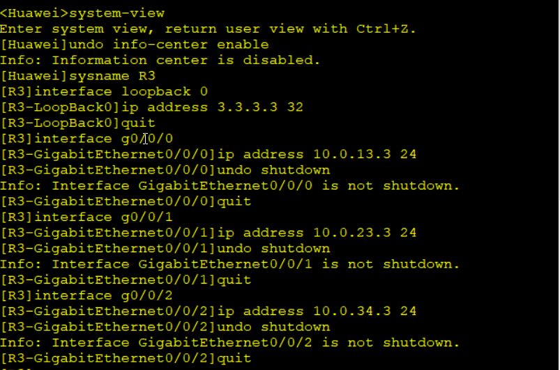

R3配置端口IP
system-view
[Huawei]sysname R3
[R3]interface loopback 0
[R3-LoopBack0]ip address 3.3.3.3 32
[R3-LoopBack0]quit
[R3]interface g0/0/0
[R3-GigabitEthernet0/0/0]ip address 10.0.13.3 24
[R3-GigabitEthernet0/0/0]undo shutdown
[R3-GigabitEthernet0/0/0]quit
[R3]interface g0/0/1
[R3-GigabitEthernet0/0/1]ip address 10.0.23.3 24
[R3-GigabitEthernet0/0/1]undo shutdown
[R3-GigabitEthernet0/0/1]quit
[R3]interface g0/0/2
[R3-GigabitEthernet0/0/2]ip address 10.0.34.3 24
[R3-GigabitEthernet0/0/2]undo shutdown

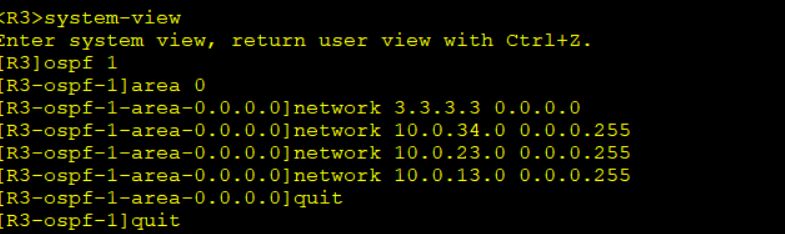

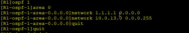

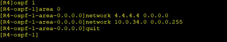

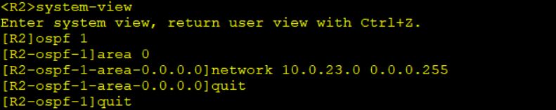

[R3-GigabitEthernet0/0/2]quit2.设置ospf进程,实现路由间的互通 224422b6fz2m4kqy40zn4w.png

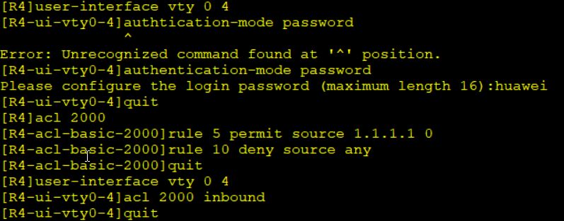

R43.进入远程登录接口,设置密码登录,创建标准访问控制列表,只放行1.1.1.1地址: 224423h7eskgebsd1e0s3q.png
[R4]user-interface vty 0 4 //进入远程登陆接口,允许5个单位访问
[R4-ui-vty0-4]authentication-mode password //模式为密码登录
Please configure the login password (maximum length 16):huawei //密码设置为huawei
[R4-ui-vty0-4]quit
[R4]acl 2000 //定义基本访问控制列表2000
[R4-acl-basic-2000]rule 5 permit source 1.1.1.1 0 //只允许1.1.1.1访问
[R4-acl-basic-2000]rule 10 deny source any //拒绝其他任何IP访问
[R4-acl-basic-2000]quit //退出
[R4]user-interface vty 0 4 进入远程登录接口
[R4-ui-vty0-4]acl 2000 inbound //在入口应用基本访问控制列表2000

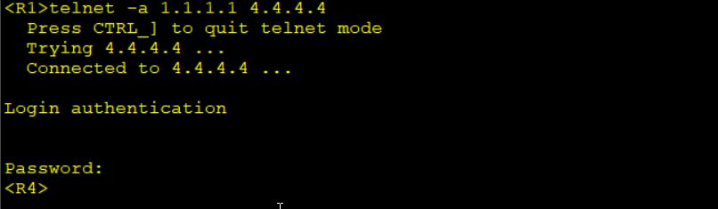

[R4-ui-vty0-4]quit //退出4.R1 telnet R4 验证实验成果 224423p9ofoloydfrlzrh6.png
成功登录
