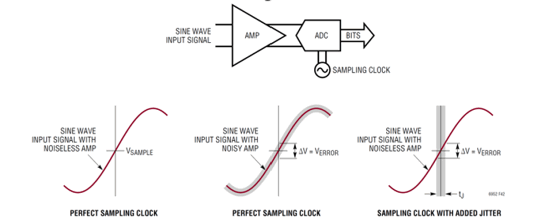

图3 Jitter对采样系统的影响

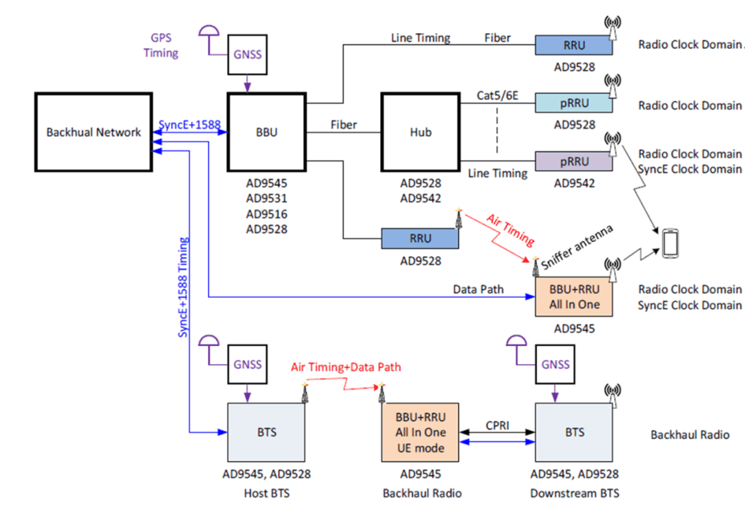

实用案例1:
AD9528 — JESD204B/JESD204C Clock Generator with 14 LVDS/HSTL Outputs
Application: 5G small cell — RU timing for transceiver and FPGA
Features:
1. 可支持14路LVDS/HSTL输出,最高输出频率可到1.25G
2. 双环路时钟发生器架构,PLL1作为输入时钟clean up,支持110MHz的鉴相频率,外部VCXO输入;PLL2作为第二级锁相环,支持275MHz的鉴相频率,内部集成VCO
3. 时钟抖动小于160fs@122.88 MHz,12 kHz to 20 MHz integration range
图4 AD9528/AD9545时钟在Small Cell的应用

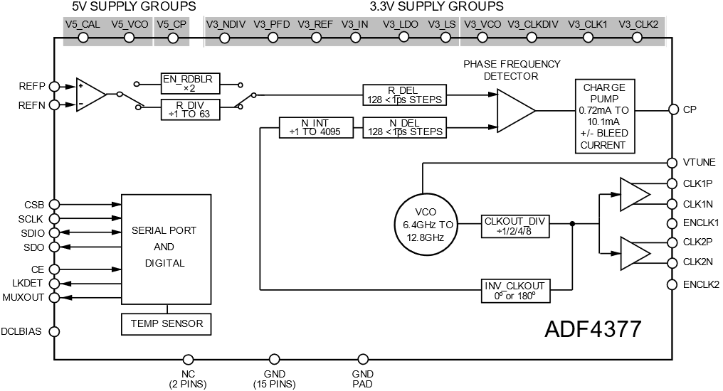

最新宽带时钟产品ADF4377及应用
ADF4377 — Microwave Wideband Synthesizer with Integrated VCO
●   Application: High speed data converter clocking above 3GHz samplerate, MxFE sample clock
●   Preferred companion chip to the AD9081/2, AD9177, AD9207/9, AD9986/AD9988, and data converters such as the AD9213ADC, or the AD9689, AD9208, AD917xDAC and AD916x
Features:
1. 输出频率高达12.8GHz,内置6.4-12.8GHzVCO,无需倍频,没有了FOUT/2和3*FOUT/2的谐波
2. 超低时钟抖动:Jitter=18fs RMS (integration bandwidth: 100Hz to 100MHz), Jitter = 27 fs RMS (ADC SNR method)
3. 超低的宽带噪底:−160 dBc/Hz at 12 GHz,Low In-Band Phase Noise (PhN),In-Band PhN Floor = -239dBc/Hz (>3dB better than any other),In-Band 1/f PhN = -147dBc/Hz (>13dB better than any other)
4. 鉴相频率高达500MHz,输入基准源频率高达1GHz
图6 ADF4377系统框图

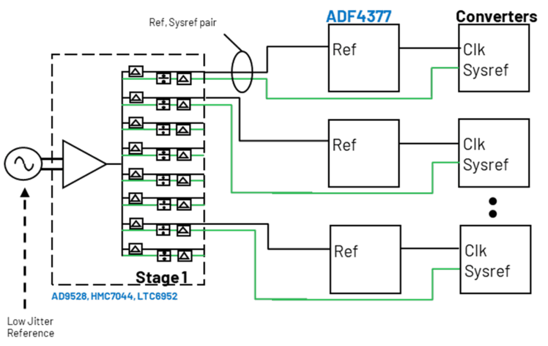

图7 ADF4377给高速数据转换系统提供低噪声时钟

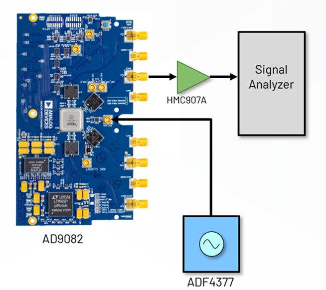

图9 ADF4377给AD9082提供时钟

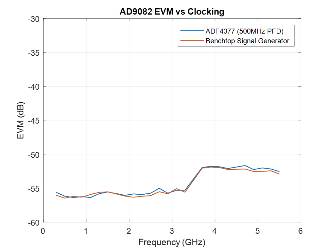

图10 ADF4377给AD9082提供时钟,EVM测试对比
