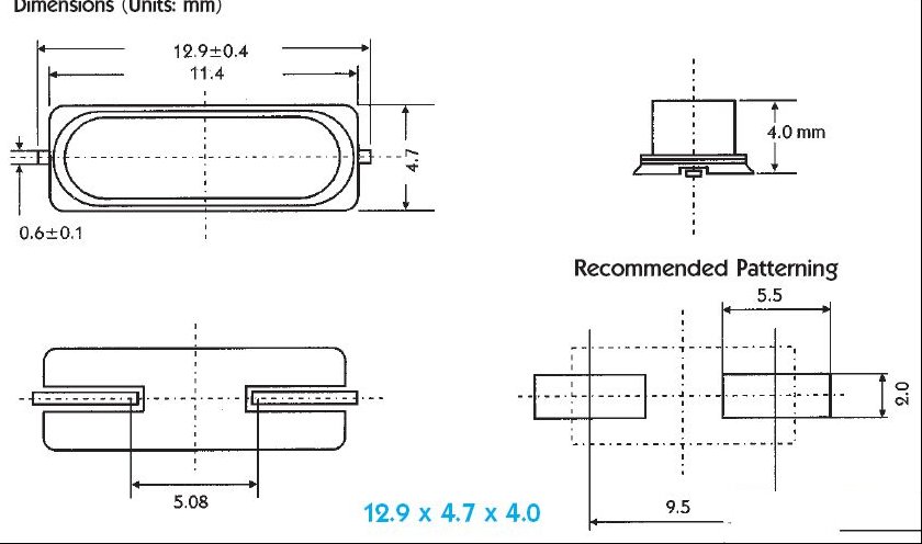

  4、SM-49 3.2 - 66 MHz 12.9 x 4.7 x 4.0

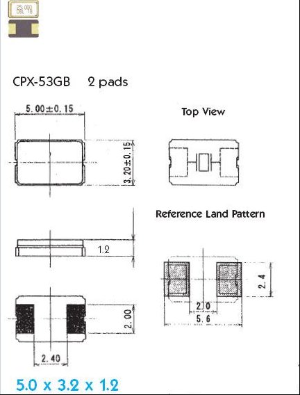

  22、CPX-53GB 8 - 50 MHz 5.0 x 3.2 x 1.2

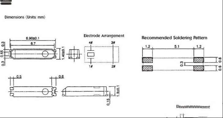

  7、 MM-11B 32.768 kHz 6.9 x 1.4 x 1.3

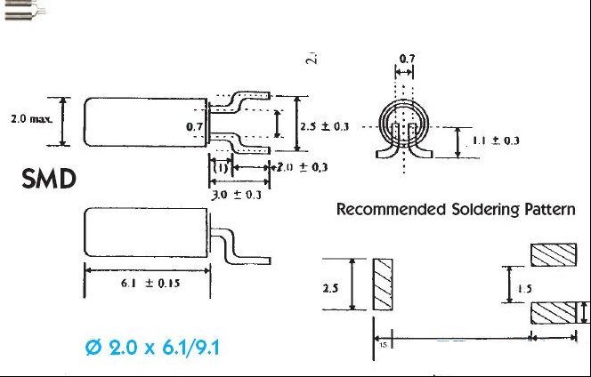

  8、TSM-250 77.5 - 120 kHz Ø 2.0 x 6.1/9.1
  9、 TSM-26B 32.768 kHz Ø 2.0 x 6.1/9.1

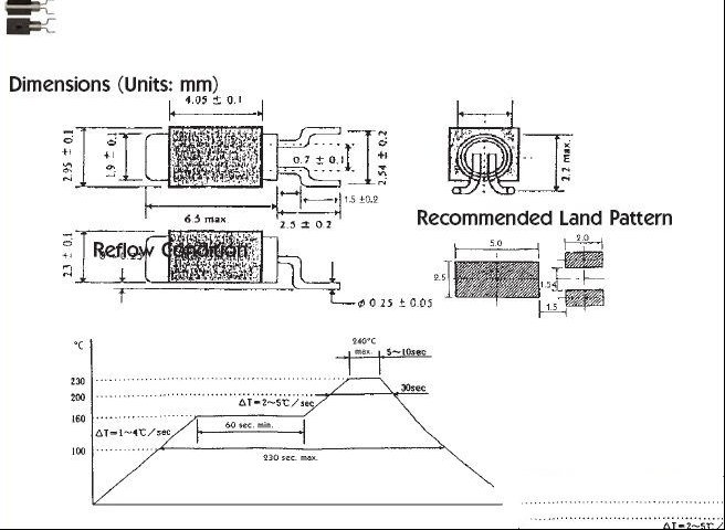

  10、TSM-26BJ 32.768 kHz 2.95 x 2.3 x 6.5/9.0

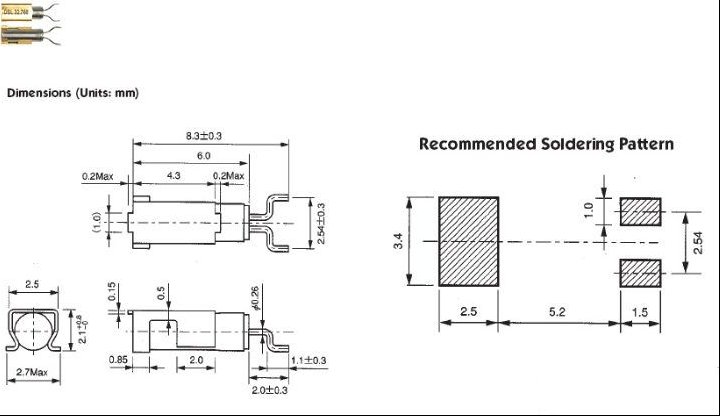

  12、CMJ-206 32.768 kHz 6.0/8.3 x 2.5 x 2.1
